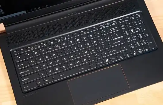

And here is an image of the keyboard layout from LaptopMag's review:
(source: purch.com)
It's those two keys that are on the right side of the spacebar.

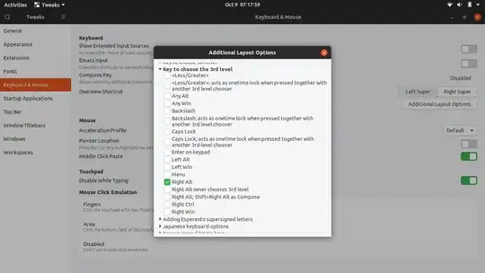

To remove the modifier from Right Alt, the best way is to use either gnome-tweaks or gsettings
Gnome-Tweaks: enter image description here
