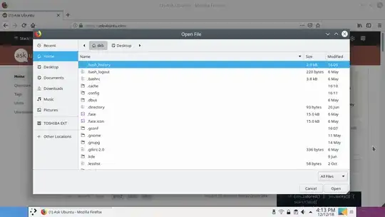

This is an image of the GTK file selection dialog in Firefox 64:

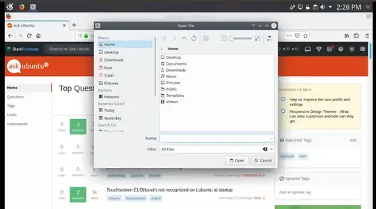

And this is what the KDE file selection dialog looks like in Firefox 64:
