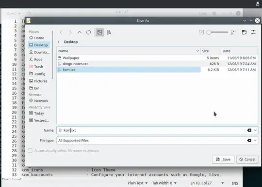

I'm using Kubuntu 18.10 and have the default file manager, Dolphin, set up quite nicely with servers, favorites etc. in the sidebar.
Now, whenever I want to open a file or folder from within a program, this file picker opens:
Now, many programs open this file/folder picker instead of the Dolphin file picker:
File Picker
EDIT: This happens for example in Sublime Text and Firefox. Preinstalled programs (e. g. Spectacle or Kate) seem to actually do display a Dolphin file picker!
Is there any way to replace this with the Dolphin file picker, or at least get my favorites etc. into whatever this program is?

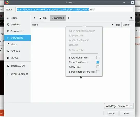

As you have seen, native applications such as Spectacle do conform, but others don't. This is probably because the non-conforming applications are gtk-based and use the GTK file selection dialog:
Firefox uses the gtk file selection dialog by default
Firefox using the gtk file selection dialog

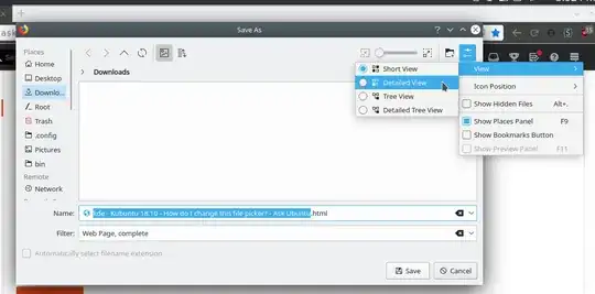

To get Firefox, which is a gtk application, to use the KDE file selection dialog, start it from a terminal like this:
GTK_USE_PORTAL=1 firefox
Now, you'll see
Firefox using the KDE file selection dialog
