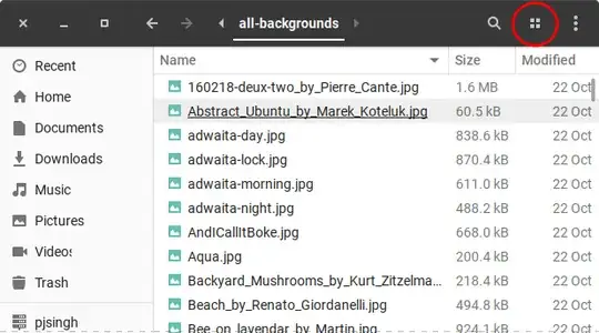

  3. Open Nautilus and navigate to the pictures folder you want to view.
  4. Click on the "Icons View" grid in the header bar.

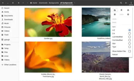

  5. Here is the thumbnails view with larger icons (100% = 400px). You can still scale them bigger or smaller from the new large default size you had set in step 1.
    Nautilus with larger thumbnails icons

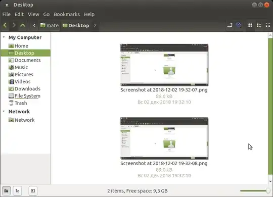

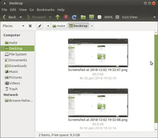

It is time to switch to MATE or Cinnamon with their file-managers
  • Caja
    Caja on Ubuntu MATE 18.04.1 LTS
  • Nemo
    Nemo on Ubuntu MATE 18.04.1 LTS
as both they have 400% zoom.
