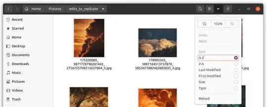

I was having the same question with you. Seems that the latest version on gnome does not allow the change of thumbnail size as you described. A little more experimentation on my PC and I found the solution myself, so I want to share it here.
through dconf-editor navigate to /org/gnome/nautilus/preferences/ There you will find
"use-experimental-views false"
Change that to true (with the knob) and then open nautilus. Use the view options next to show list and you will see that now you can increase the level to 267%
Enjoy
Screenshot
