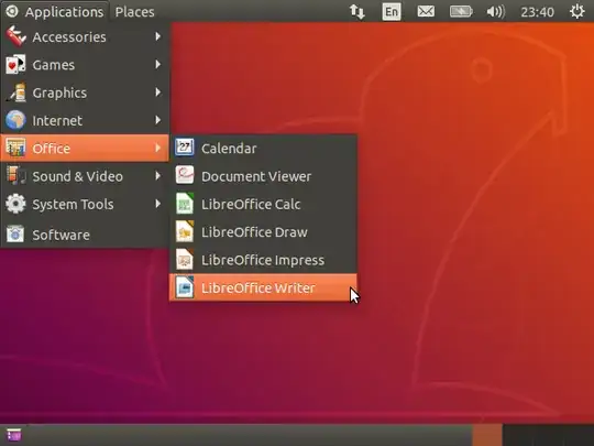

You can try to switch to GNOME FlashBack with
sudo apt-get install gnome-panel

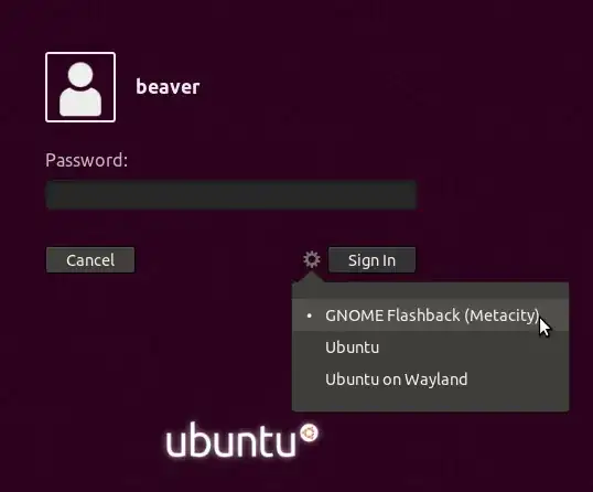

and then logout and select session on login screen:
selecting metacity session
and you desktop will look like:
gnome flassback
But it will not fix the wide gaps in the current GNOME apps and extension-for-every-previously-existed-function fashion.

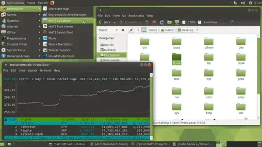

So real solution may be to switch to traditional feature-rich desktop - MATE DE with
sudo apt-get install ubuntu-mate-desktop^ and forget GNOME as bad nightmare:
MATE traditions
