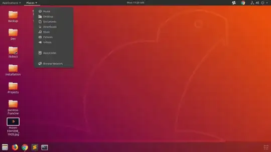

I Updated my Ubuntu from 17.10 to 18.04 now the Application menu on top is not showing the drop down when clicked on it.
The Places Menu is Working but the left Applications Drop down is not working:

You have to activate "hot corners" with gnome-tweak-tools.
It worked for me.

I had the same problem. Go to Tweaks,then Top Bar, and "turn on" the Activities Overview Hot Corner. Applications menu will appear.
The combination of the the two answers by Rakesh Roy and PhJ worked for me. You have to both activate the hot corners and also change shell version to 3.28.1.
