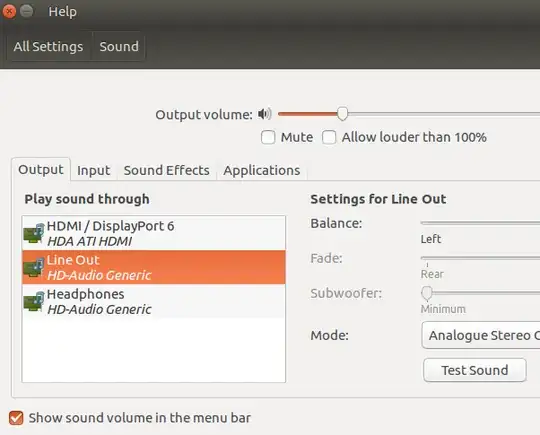

See my answer for 18.04 - it also works for 16.04.
Once I followed these instructions, my Line Out and Headphones (mine is actually a headset with mic) started appearing separately in the Ubuntu 16.04 'Sound' app whereas before there was only one or the other displayed. I can swap the output device using by clicking on it in the Sound app.
In brief, you need to edit Pulseaudio mixer's configuration files:
  • /usr/share/pulseaudio/alsa-mixer/paths/analog-output-lineout.conf
  • /usr/share/pulseaudio/alsa-mixer/paths/analog-output-headphones.conf
