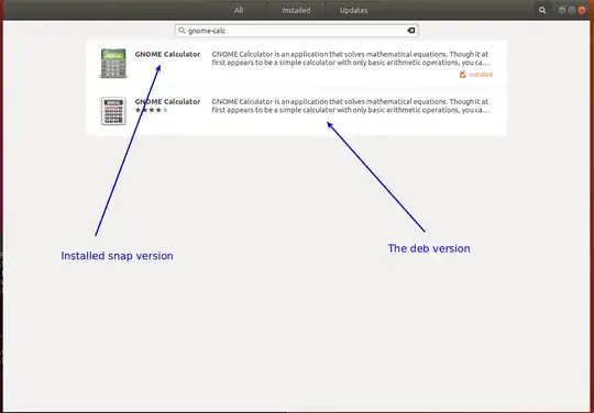

Click on the Ubuntu Software icon and search for gnome-calc:

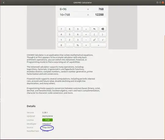

To verify which is which, click on each one in turn. When you click on the installed version and scroll down you will see:
Note the Snap Store at the bottom

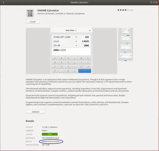

When you click on the second one and scroll down you will see:
Now you can click on Remove button for the snap version to remove it. Similarly click on the Install button to install the deb version. In both cases you will be asked for the password.
