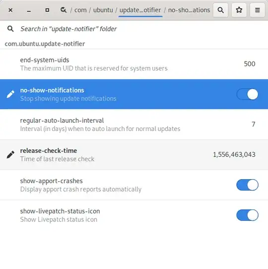

You can set the update-notifier not to show notifications, either by GUI or by CLI.
CLI
gsettings set com.ubuntu.update-notifier no-show-notifications true
GUI
Open the program dconf-editor and navigate to
"com->ubuntu->update-notifier" and toggle the switch for "no-show-notifications"
