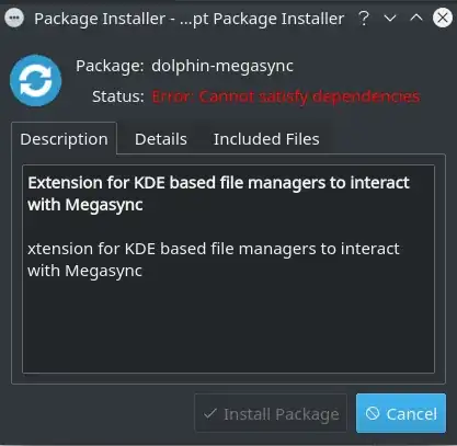

  • Qapt Package Installer (qapt-deb-installer) is meant as similar to Gdebi, but, while it tells you when dependencies are missing, it doesn't list those missing dependencies.

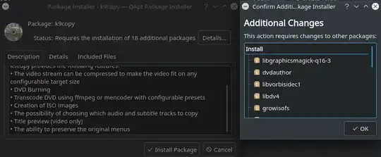

On the other hand (like Gdebi) it tells you what supplementary dependencies are installed when executing a deb file.
  • Discover is similar in that it is able to install from deb files (unlike something like Synaptic or its KDE alternatives, Muon and Apper). But, just like qapt, it doesn't tell you what dependencies are missing, just says that they are so:

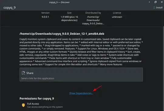

It does list the supplementary dependencies before installing them by clicking "Show dependencies..." before clicking "Install":

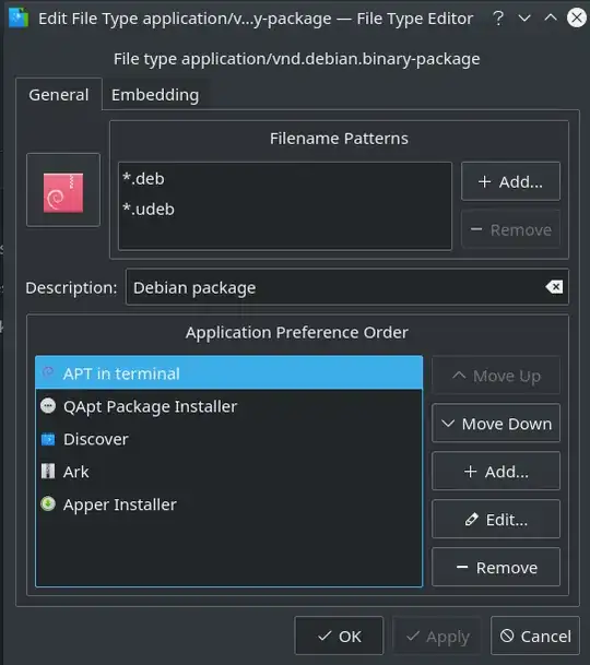

  • by associating the deb files with an "application" that would trigger our action, in fact just the desktop file ~/.local/share/applications/install-deb-terminal.desktop, created by us with the form

but that will be seen by the system as a new application that could be associated to the deb file-type

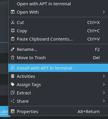

  • or, by just creating a new context menu in Dolphin for deb files, triggering the same action, with the file ~/.local/share/kservices5/ServiceMenus/install-deb.desktop of the form
[Desktop Entry]
Actions=install
Icon=dialog-information
MimeType=application/vnd.debian.binary-package
ServiceTypes=KonqPopupMenu/Plugin
Type=Service
X-KDE-Priority=TopLevel
[Desktop Action install] Exec=konsole --hold -e sudo apt install %f Icon=/usr/share/icons/breeze/mimetypes/22/application-x-deb.svg Name=Install with APT in terminal

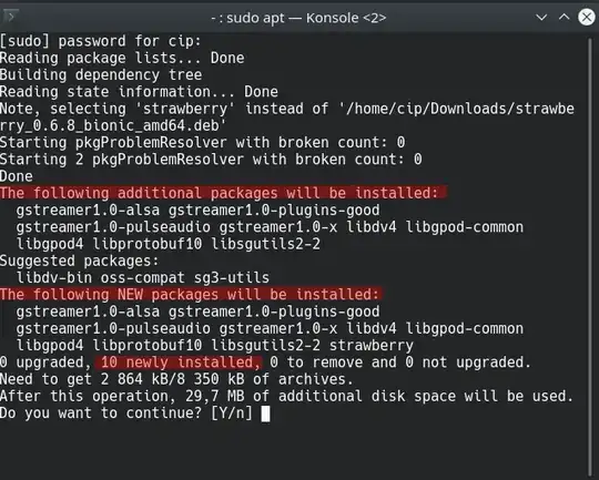

I guess Dolphin qualifies as a GUI for our purpose. The rest is displayed in terminal - that is: missing dependencies, if the case,
or supplementary ones that need to be installed:
But we do not take any action in CLI ourselves, except entering the sudo password.
