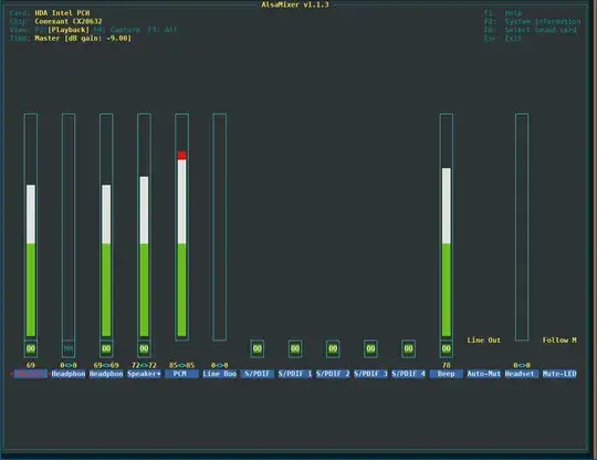

I am running Ubuntu 18.04 LTS. I was having USB audio mutes below 35 % issue. So I followed the instructions at over here to fix it. And it worked. But now internal speakers don't work anymore.

Doing sudo alsa force-reload didn't work. What can do to get my internal speakers working again?
