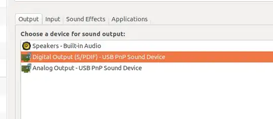

I am on ubuntu 18.
I was just playing around and found that in the sound settings, under output devices, there were 3 devices:
SOUND OUT PUT DEVICES LIST
and Analog output - USB PnP Sound Device was selected, i just selected the Digital one, and it solved my issue.
Any explanation of why it worked would be perfect addition to this answer.
It solved the issue for me, and when i unplug and plug headphones again, it still works and selects Digital Output by default.
