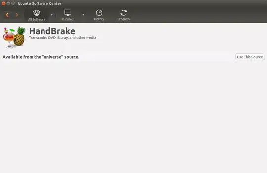

HandBrake is available in the Ubuntu Software Center, search for it
If you have not made any changes to your Software Sources, you should be directed to an install page instead of what is in the above image. To add the "universe" source to your sources, go to Edit>Software Sources and check under the tab Ubuntu Software the "Community-maintained free and open-source software (universe)" and close.
Or just click the button to use that source.
