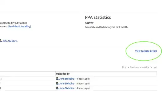

  1. Used the Handbrake Snapshot PPA found here
  2. Click on View Package Details

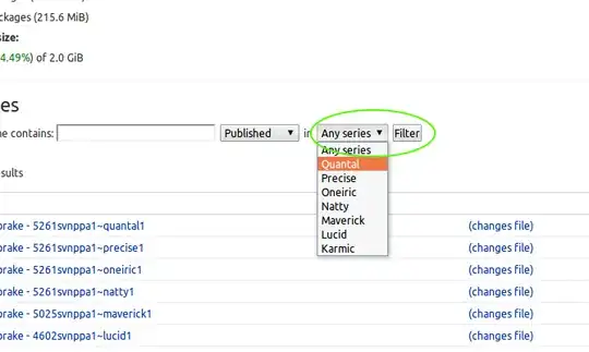

  3. Select the Ubuntu version you are using, then click on Filter

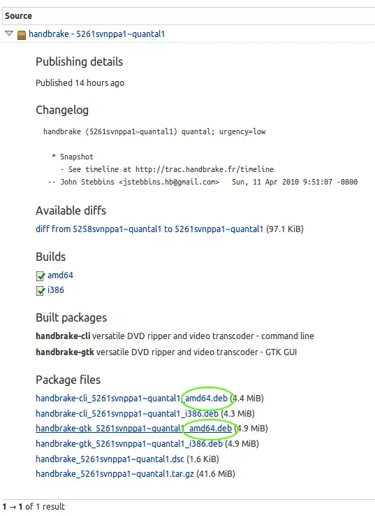

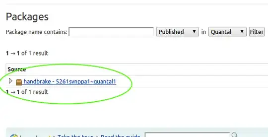

  4. Click on the most updated Package available there. In this case there is only one. It should expand to show everything related to that package.
  5. Go down until you get to where all packages for each Architecture are shown. Download the ones that are for your version. In this case, the ones that say amd64 are for 64 Bit systems.
  6. After downloading both (The CLI and GUI Versions), simply double click them. Software Center will take care of the rest.

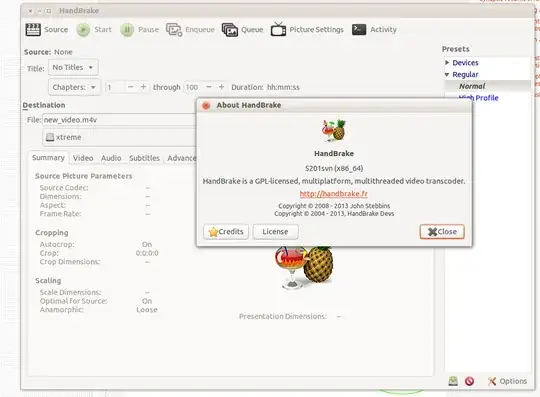

The end result should be something like this:
This is what I did on 12.04, 12.10 and even on 13.04 using the 12.10 package. All cases with 64 Bit PCs.
