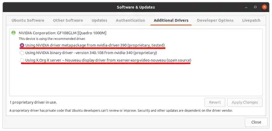

I've had the same "HDMI output not working" problem occur multiple times on a computer and I found a working solution.
It ended up being Ubuntu switched my graphics driver from a working proprietary one to a partially-working open source one (as in it doesn't work with a connected HDMI output). This switch most likely happened during an update.
So to fix that, I went to Settings -> About -> Software Updates and then chose the a "proprietary, tested" driver instead of the "open source" one.
Afterwards, I restarted the computer and the external HDMI output worked. enter image description here
