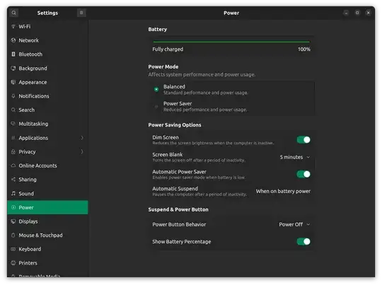

I tried commenting out options nvidia-drm modeset=1 in /lib/modprobe.d/nvidia-kms.conf file and leaving Power mode. I am currently running on Balance mode. enter image description here

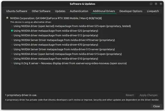

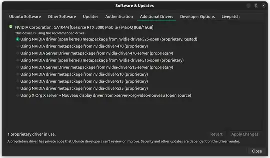

Ok so apparently the solution was super easy, even though now I am asking myself some "why?".
I could solve the problem by switching from the recommended driver for NVIDIA graphics to the proprietary non-open,
$ sudo ubuntu-drivers devices
== /sys/devices/pci0000:00/0000:00:01.1/0000:01:00.0 ==
modalias : pci:v000010DEd000024DCsv000017AAsd00003A58bc03sc00i00
vendor   : NVIDIA Corporation
model    : GA104M [GeForce RTX 3080 Mobile / Max-Q 8GB/16GB]
driver   : nvidia-driver-525-open - distro non-free recommended
driver   : nvidia-driver-515 - distro non-free
driver   : nvidia-driver-515-server - distro non-free
driver   : nvidia-driver-470 - distro non-free
driver   : nvidia-driver-510 - distro non-free
driver   : nvidia-driver-525 - distro non-free
driver   : nvidia-driver-470-server - distro non-free
driver   : nvidia-driver-515-open - distro non-free
driver   : xserver-xorg-video-nouveau - distro free builtin
with the reference to the above output from nvidia-driver-525-open - distro non-free recommended to nvidia-driver-525 - distro non-free, or with the GUI, from the 1st one to the 2nd.
Then what recommended means? I sense this is a misleading recommendation, and I suggest to maybe give some informations about that choice, maybe explaining that with some notebooks one is recommended, and with another another one is.
Hope this helps.
