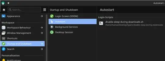

Step 4: Add this script to autostart on login, then reboot.
  1. Go to your system settings, and add this script to run on autostart in the settings.
Add script to autostart on login

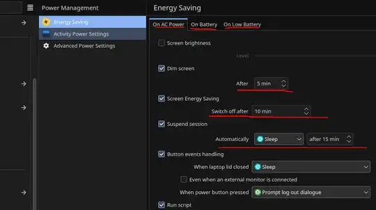

Step 6: Go to the Ubuntu Settings and set your sleep options as normal
Configure sleep settings through the system settings like you normally would.
Now you can go into the regular systems settings, and set your desired sleep settings like normal. This script does not interfere with those settings, and your computer will sleep like normal, but not during a download.
