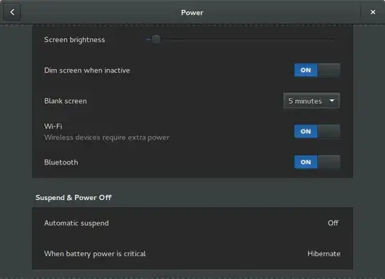

I was able to find the power settings, which gave surprisingly few options:
power options
However, I am unsure about a couple of things
Is there a way in which my computer does not suspend during downloads, but my screen is still shut off when I am not working on it during download? Are there settings to be made to achieve this, or other solutions?
