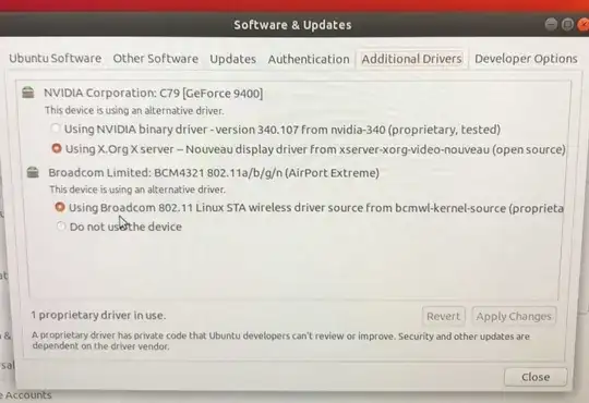

I recently installed Ubuntu 18.04 on my 2009 mac mini. I used a bootable flash drive and all is well. Initially, WiFi adapter where not found, but after going into the Software & Updates > Additional Drivers and installing and using the Broadcom 802.11 Linux STA wireless driver source from bcwl-kernel-source.
image of additional driver

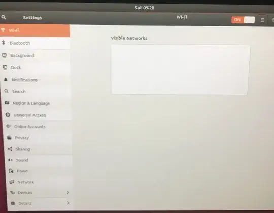

However there are no visible WiFi networks even though there are at least three around me as my phone and laptop are connected to them.
Image of no visible WiFi networks
