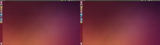

On my dual screen display I have a Unity Launcher on the left hand screen and also on the right hand screen. Both work perfectly fine.
However, I don't want this second launcher present on my right hand screen. How could I remove this? If it matters, I'm using NVIDIA drivers with a TwinView setup.
A dual screen setup where both launchers are visible

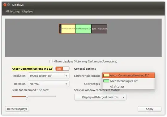

You can now.
Open up Display preferences, and then you can choose between having the launcher on one display or all of them.
This dialog also allows switching on or off the sticky edges (i.e. the mouse slowdown) between the displays.
