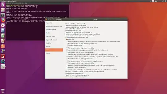

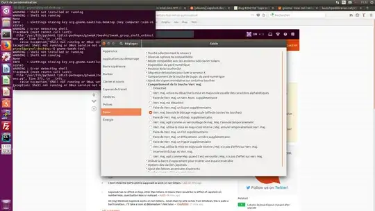

From How can I remap the caps lock key to be shift
  1. Install gnome-tweak-tool:
    sudo apt install gnome-tweak-tool
  2. Start gnome-tweak-tool:
    gnome-tweak-tool
  3. Change the CapsLock behavior from Deactivated to CAPS Lock activate the Shift Lock
    default tweak tool CAPS Lock is SHIFT Lock
You can now type 1234 with CapsLock (but be careful, Shift + Mouse on an application icon open a new window).

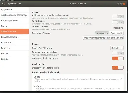

UPDATE for 18.04:
  1. Start gnome-tweaks
    gnome-tweaks
  2. Go to Keyboard & mouse -> Additional Layout Options (refered as Options supplémentaires d'agencement on my screenshot) -> CapsLock Behavior
  1. Change CapsLock from Desactivated to Use CapsLock as Shift (there are some different options, test and choose which one fits to your use)
