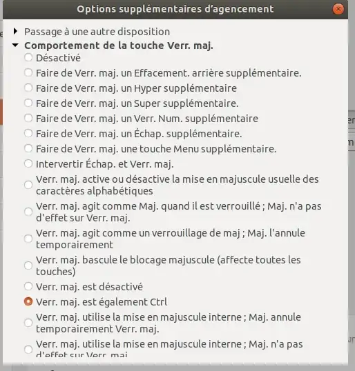

  1. Install gnome-tweak-tool
    sudo apt install gnome-tweak-tool
  2. Start gnome-tweaks
    gnome-tweaks
  3. Go to Keyboard & mouse -> Additional Layout Options (refered as Options supplémentaires d'agencement on my screenshot) -> CapsLock Behavior
  4. Change CapsLock from Deleted to CapsLock is also Ctrl
  1. Change CapsLock from Desativated to CapsLock is also Ctrl (refered as Verr. maj. est également Ctrl on my screenshot)
This is the GUI way, using gnome-tweak-tool, I don't know if it fits your goal
