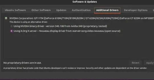

I also had a same problem. After couple of trials here and there finally able to solve it.
  • Go to Additional Drivers
  • There click on using X.org server and hit apply changes.
  • Restart your system
Link for Additional Drivers Image
