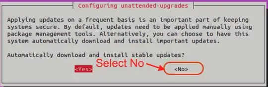

As of Ubuntu 20.04 [and this may be true of 18.04 as well, not sure], the preferred way to disable this is to use dpkg-reconfigure:
sudo dpkg-reconfigure -plow unattended-upgrades
and select "no" to the prompt.
