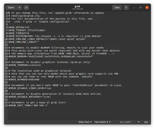

When I boot my ubuntu 20.04 on a Samsung laptop, the brand name shows up for 40 seconds. Then the ubuntu purple screen appears then it instantly loads further. Is there any way to configure some settings so as to not to wait to see my laptop's brand name for 40 seconds? My grub looks something like this.
Grub

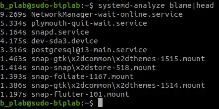

systemd-analyze blame|head output

If you are tired of staring at the logo while it boots, you can press esc or tab whie it boots and watch the boot messages. If you like this better, you can make it permanent by removing quiet splash from the grub command line in /etc/default/grub and run update-grub. (Some people think the logo is pretty. I'd prefer to know what is going on.)
If is the slow boot that annoys you rather than actually staring at the logo, you can use systemd-analyze to mesure what is taking so long in the boot and optimize it.

Your output from systemd-analyze blame says at least 9 seconds of that 40 could be ubuntu booting.
