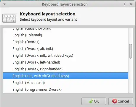

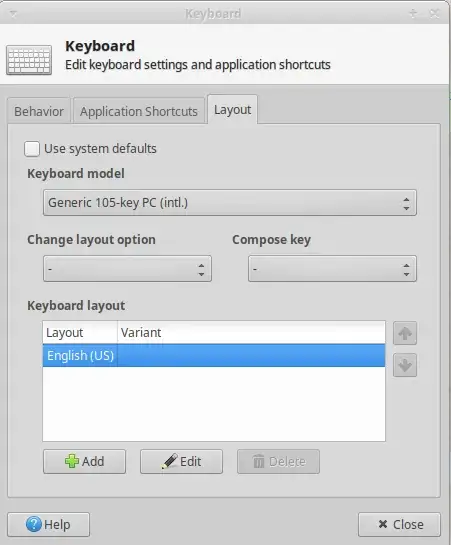

In XUbuntu 18.04:
Open the keyboard window:
Then, Select keyboard layout selection by clicking on Edit and chose the option you like more. In this case English (intl., with AltGr dead keys)
I write this also for myself: for the next laptop, I will have again the same problem and I will search for the solution again and again and again.
