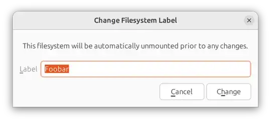

  1. Open "Disks" application
  2. Select the flash drive in the panel on the left
  3. Press the Unmount button (should look like a "stop button")
  4. Click on the gears icon ("More actions") and choose "Edit filesystem"
Screenshot: This filesystem will be automatically unmounted prior to any changes
