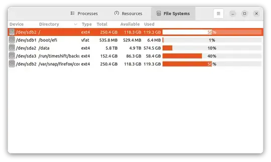

There certainly is an easy way to specify the drive a file is going to - it's just not all that obvious to newbies coming from Windows. If you open the System Monitor and click File Systems at the top, you can see a list of all the drives, how big each is, and how much of each is consumed. If the drives are all of different sizes & you know the size of the one you want to use, that information should be sufficient to figure out which of the lines you're interested in.
The key you're looking for is in the Directory column (which may also help identify the drive you want). In that column you can see 1) what directory to put your file under to make sure that it's on the drive you want, and 2) in the name of the directory, a description of what's on the drive. enter image description here
If you do not see all of the columns shown here, you can right-click on the header of one of the columns and see a checklist of which columns to show.
