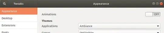

18
While animations are nice and eye-catchy, after awhile they might be annoying. To disable animations first install Gnome Tweaks:
sudo apt install gnome-tweaks
Then launch tool either from command line by running
gnome-tweaks
or by using dash and searching for Tweak.
gnome-tweaks was previously known as gnome-tweak-tool. Try that if you are using an older version than 18.04.
On the first tab Appearance there is a toggle switch Animations.
screenshot
That's it!
Source: How to disable animations in Ubuntu 17.10 or 18.04?

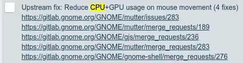

18
There appears to be a relevant issue in GNOME with fixes pending. I'm seeing moderately high (30-40%) CPU usage even just moving the mouse around, and these optimizations will supposedly address that:
Unfortunately, as GNOME 3.30.2 is already released, these fixes likely won't make it until 3.32 is released around next March. Given the impact of this issue, I hope the maintainers will consider another hotfix release of the 3.30 series! (@Daniel van Vugt)
Additional references:
