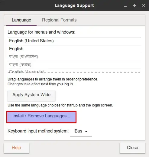

  1. Go to Language Support. Click install/remove languages.
    Language support dialog

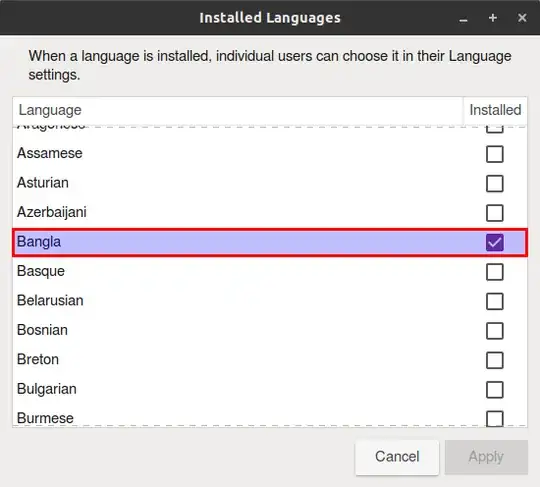

  2. Select Bangla from the list and click apply. After installing Bangla language support you should start installing Avro.
    Installed Languages dialog

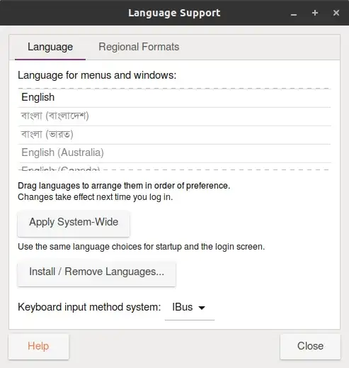

  3. The resulting window should look like this:
    Language Support dialog with Bangla

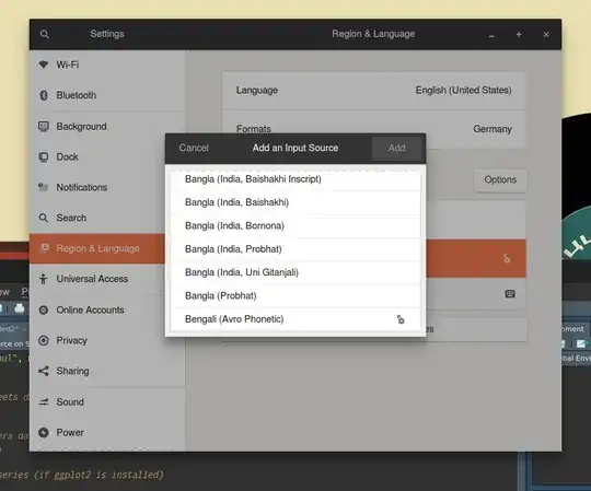

  7. Now go to Settings > Region and language > Add an input source > Bangla > Bengali (Avro Phonetic)

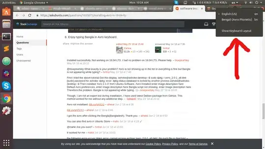

  • Settings > Region and language > Add an input source > Bangla (or Other) > Bangla (Avro Phonetic)
I've installed successfully and found the settings for input source at the top bar.
