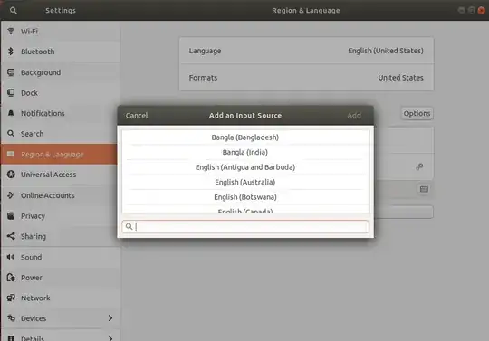

I faced the same thing. In my case, I uninstalled Bangla from Language input source. Unistalled Avro too. Then Reinstalled Avro from here. Then do the things stated below.
Just click on Bangla(Bangladesh) Like this Image and a new window will come.

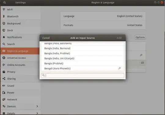

Select Avro Phonetic from there. Like this one I think it will fix the thing!
