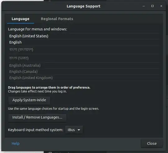

I have followed each step as instructed. I think the main problem occurs of my installation is in Manage Installed Languages. In Manage Installed Languages, after adding Bangla language package, I am losing all Bangla language selection options in language choose list.
The below mentioned pictures visualize the result of Bangla language package installation and result of the installation:
**Bangla Language Package** has been installed
After installing the language, the language selection list look like this: Language selection list after Bangla language package installation

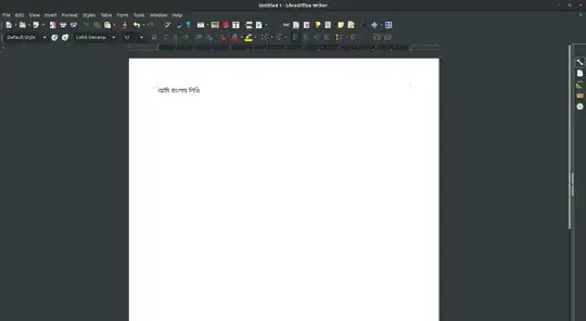

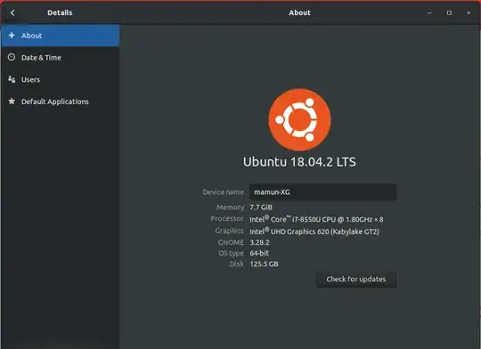

After successfully adding Avro phonetic I got following output from different environment:
  • System Info
enter image description here - Web Browser
enter image description here - Libre Office

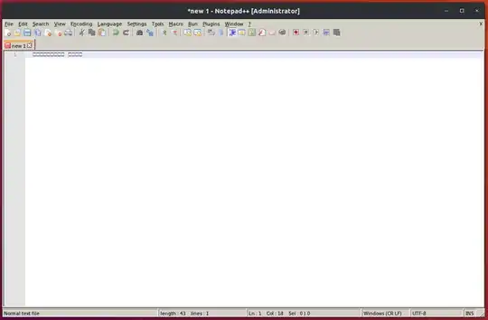

enter image description here - Notepade++

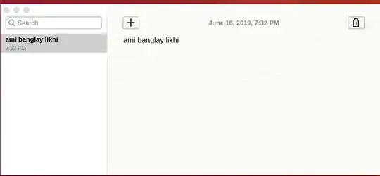

  • StickyNote

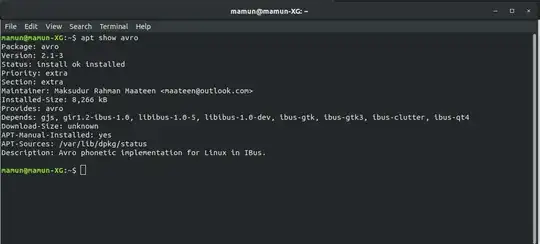

  • Avro version

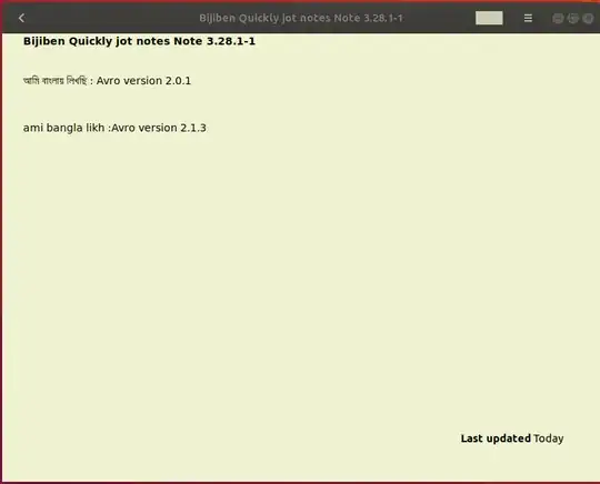

  • Avro 2.0.1 and 2.1.3 behavior in Ubuntu Default Text Editor
  • Avro 2.0.1 and 2.1.3 behavior in Bijiben Quickly jot notes Note 3.28.1-1

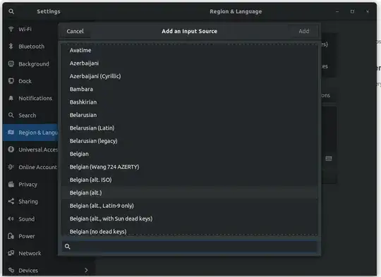

When you installed the Bangla language from "Manage Installed Languages", the Bangla/Bengali input source options were moved from the "Other" window. Actually I think that you now see a "Bangla" item at the very first window when clicking the + button, and if you select "Bangla", a sub window will open with a number of options, including "Bengali (Avro Phonetic)".
