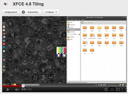

According to this article - there is a patch available to enable windows tiling (aka windows snap) for the xfwm4 compositing manager.
There is a great you-tube video showing this in action.
I have applied this patch and uploaded this to my PPA.
