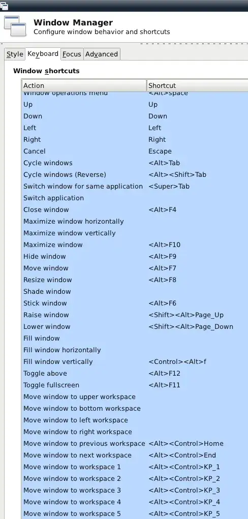

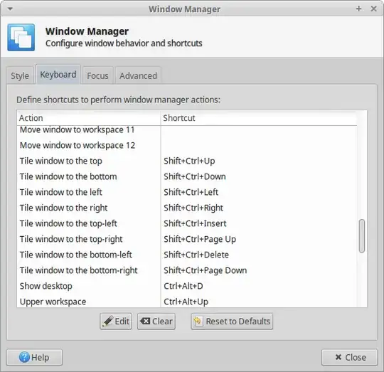

Xubuntu LTS 16.04 has the ability to tile windows by default by using the mouse. Grab a window with your mouse and move it to the top, bottom, left, right, top-right, top-left, bottom-right or bottom left.
If you want to use your keyboard instead, you have to configure the shortcuts in the Window Manager as the following screen shot shows:
Window Manager
I answered this old question here because as a Xubuntu novice I was looking for this feature too and couldn't find it in the beginning.

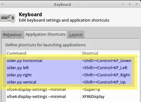

Keyboard Tiling

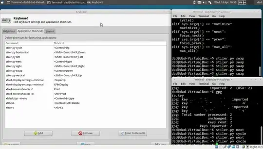

A basic python script on launchpad allows you to control windows such as moving them to the left or right.
I've slightly modified this to work with XFCE/Xubuntu and to allow you to install in either 11.10 or 12.04. This can easily be tailored for other DEs such as unity-2d
Create keyboard shortcuts - an example is below:
You call the script stiler.py with the following parameters:
  • left - tile the current window to the left side of the screen.
  • right - tile the current window to the right side of the screen.
  • vertical - tile all windows vertically
  • horizontal - tile all windows horizontally
  • cycle - tile windows in a cyclical manner and rotate between those windows
  • prev - move the focus to the previous window
  • next - move the focus to the next window
  • maximize - maximise the current window
Some examples:
cycle windows
tile vertically

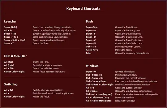

Just Press and hold super key and you will get most useful shortcuts in ubuntu as shown in image.
