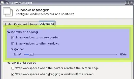

Using a lightweight window manager
You could use the lightweight compositing manager used by XFCE called xfwm4
This will give you basic windows snap.
N.B. if you dont like the default "change workspace when dragging a window off the screen" capability then untick the very last option shown in the picture.

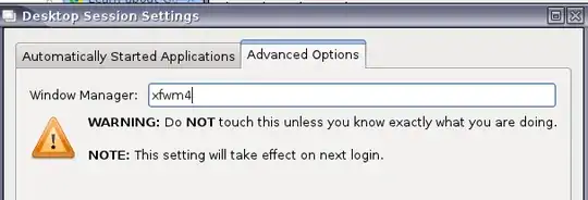

How to use xfwm4 in lubuntu/lxde
To use xfwm4 as your compositing manager instead of OpenBox.
In Desktop Settings - Advanced options change the window manager to xfwm4
Now in terminal:
cd ~/.config/lxsession
mkdir Lubuntu
cp LXDE/* Lubuntu/
Install the compositing manager:
sudo apt-get install xfwm4-themes
Logout and login for the xfwm4 compositing manager to take effect.
Change the style via xfwm4-settings
