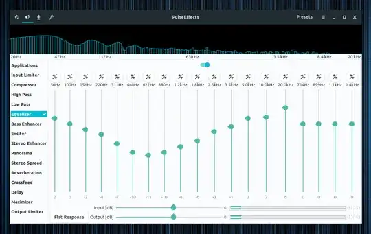

PulseEffects application has a system-wide equalizer that you can control on a per-application basis. The application also provides various sound effects / enhancements, like limiter, compressor, reverberation, equalizer and auto volume effects.
A tweak is needed for PulseEffects to work correctly in Ubuntu, see here.
Oh, here's a screenshot:
Edit: to install PulseEffects follow the setup Flatpak and Flathub using this quick guide. Then visit the PulseEffects FlatHub page and click install. You can also search for PulseEffects in Ubuntu Software (after setting up Flatpak and Flathub like I mentioned).
