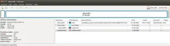

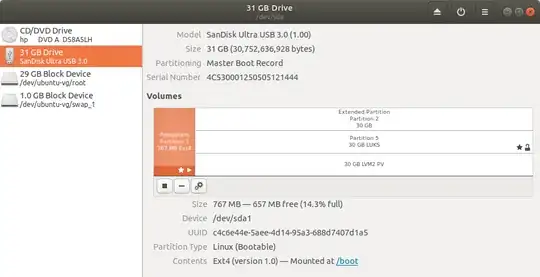

After making a fully encrypted installation to USB I examined the results with both Disks and GParted.
screenshot
screenshot
The encrypted extended partition was fully encrypted. Swap is a file within this partition, (and not a partition on its own), and is also encrypted.
Home is a directory within the encrypted partition and thus is also encrypted.
The Boot partition is not encrypted. The disk must first be booted before it can be decrypted.
