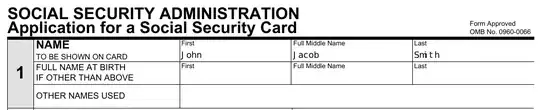

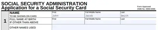

I'm using Ubuntu 18.04 and filling out the SS-5 Social Security Administration form. However, some of the letters are wrongly positioned.
Evince 3.28.2-1:
evince screenshot (has kerning issues)

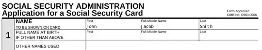

Okular 1.3.3 (Ubuntu version 4:17.12.3-0ubuntu1):
Okular screenshot (has kerning issues)

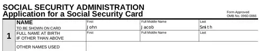

xpdf 3.04-7:
xpdf screenshot (has kerning issues)

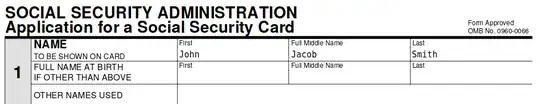

mudpdf 1.12.0:
mupdf screenshot (no kerning issues)

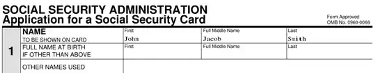

The built-in PDF reader for Firefox 59.0.2:
firefox screenshot (no kerning issues)
The built-in PDF reader for Chromium 65.0.3325.181:
chromium screenshot (no kerning issues)

    It seems like Evince and xpdf are using a variable-width font when they should be using a monospaced font, and maybe this is causing the positioning problem.

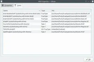

The problem you are observing is caused by incorrect font substitution. On my computer, CourierStd and ZapfDingbats are replaced with Ubuntu. That will obviously not render properly.
pdf font properties
To correct this:
  • Install fonts-urw-base35. This should correct the Dingbats and most other pdf font substitutions. However, CourierStd substitution is not fixed because it is not in the config files.
  • To correct CourierStd, create the file ~/.config/fontconfig/conf.d/10-pdf-aliases.conf with the following contents:
