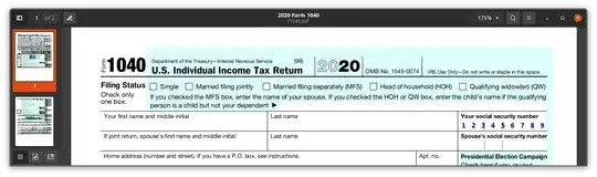

I am filling out this PDF form, IRS Form 1040, in evince 3.36.7 on Ubuntu 20.04 and having a problem that the numbers I input are not aligned correctly with the background bars. Please see this screenshot: Form 1040, DejaVu In the box filled by 123456789, the correct rendering should look like 123|45|6789, but 5 is almost pushed out to the right of the second vertical bar. The spacing between the numbers are much wider than the form creator intended.
It looks that Helvetica LT Std Bold font is assigned to this box, but I don't have this font. Ubuntu substituted it with DejaVu Sans Bold.

The fonts used in the PDF are as following. Among them, the fonts for the input fields are Zapf Dingbats, Helvetica, and Helvetica LT Std Bold. I believe the numbers in question is Helvetica LT Std Bold.
$ pdffonts f1040_ssn_sample.pdf
name                                 type              encoding         emb sub uni object ID
WVBKSB+UniversalStd-NewswithCommPi   CID Type 0C       Identity-H       yes yes yes   1193  0
XULQGZ+ZapfDingbatsStd               CID Type 0C       Identity-H       yes yes yes   1198  0
TGPSCH+HelveticaNeueLTStd-Roman      Type 1C           WinAnsi          yes yes no    1200  0
ZHOHIV+HelveticaNeueLTStd-BlkCn      Type 1C           WinAnsi          yes yes no    1202  0
XEPVGZ+HelveticaNeueLTStd-BdOu       Type 1C           WinAnsi          yes yes no    1204  0
XEPVGZ+HelveticaNeueLTStd-Blk        Type 1C           WinAnsi          yes yes no    1206  0
CEYUYP+ITCFranklinGothicStd-Demi     Type 1C           WinAnsi          yes yes no    1208  0
UXBDQF+HelveticaNeueLTStd-Bd         Type 1C           WinAnsi          yes yes no    1210  0
UXBDQF+HelveticaNeueLTStd-BdCn       Type 1C           WinAnsi          yes yes no    1212  0
ATBIWT+HelveticaNeueLTStd-It         Type 1C           WinAnsi          yes yes no    1214  0
Helvetica                            Type 1            WinAnsi          no  no  no     143  0
HelveticaLTStd-Bold                  Type 1            WinAnsi          no  no  no     144  0
ZapfDingbats                         Type 1            ZapfDingbats     no  no  no    1114  0
ZHOHIV+AdobePiStd                    CID Type 0C       Identity-H       yes yes yes     69  0
