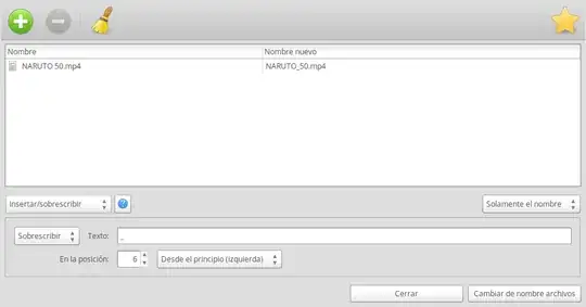

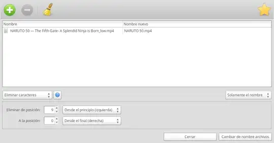

I recommend you Thunar that comes with Thunar Bulk Rename
  • Open a terminal
  • To install it, write and execute the command:
    • sudo apt install --no-install-recommends thunar
thunar-bulk-rename-1
In your case this could be the way (It's in Spanish)
First step: thunar-bulk-rename-2
Second step: thunar-bulk-rename-3
