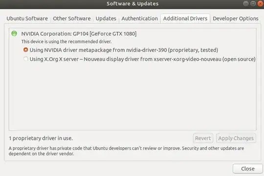

I have nvidia GeoForce GTX 1080 graphics card.
I went to Software & Updates and then to the Additional Drivers tab and selected what is given in the below image. It installed the drivers after which I rebooted and it was fine.
