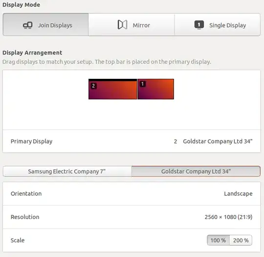

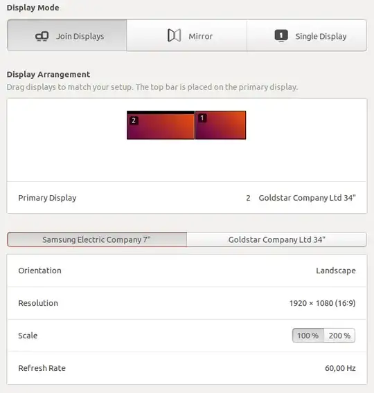

I just fresh installed Ubuntu 18.04, after some hassle I was able to install the nvidia-driver-396. I run a dual monitor setup being one a 29" ultra wide and one 24" 1080p, when I had Ubuntu 16.04 the system detected the monitors sizes without a problem, but for some reason on Ubuntu 18.04 the 29" is being detected as 34" and the 24" is being detected as 7", odd thing is that their resolutions are correct it is just the monitor size that is wrong.
VLC for some reason had huge icons on the "detected 7" monitor", I solved that by adding QT_AUTO_SCREEN_SCALE_FACTOR=0 in /etc/environment and /etc/profile.d/gnome-qt.sh
Although that solved the VLC issue the monitors sizes are still being wrongly detected, how can I solve it?
Here are some Screen Shots
This is the 29" monitor:
This is the 24" monitor:
