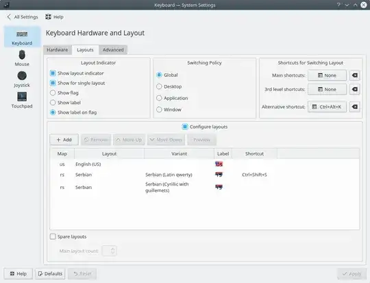

If you just want additional keyboard go to
System Settings → Input Devices → Keyboard Layouts
and add languages that you need
You can also display language indicator in statusbar.
