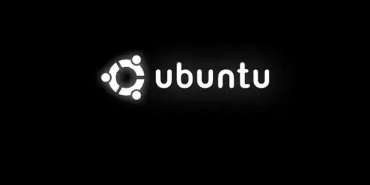

For the splash screen, you could try changing the isolinux/splash.png file in the .iso to the one you want - splash.png looks like:
You may also need to change the isolinux/splash.pcx file as well.
