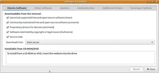

Make sure you have enabled all sections in Software & Updates and selected good mirror (I prefer Main server) in
  1. Ubuntu Software
    su1
  2. and security-updates in Updates:
    su2
Then sudo apt-get install libc6:i386 will be enough.
Or deeper:
sudo apt-get update
sudo apt-get dist-upgrade
sudo apt-get install -f
On my system libc:i386 is installed with version 2.23-0ubuntu10.
