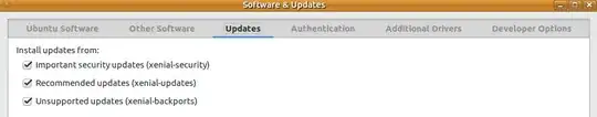

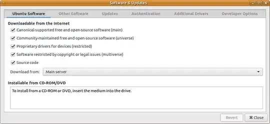

According to your sources.list, my assumption was correct - you have wrong repositories.
At first open Software & Updates (software-properties-gtk) and make it look like:
Ubuntu Software
Updates
or by changing the /etc/apt/sources.list file using text-editor opened as root to
deb http://archive.canonical.com/ubuntu xenial partner
deb http://archive.ubuntu.com/ubuntu xenial main universe multiverse restricted
deb http://archive.ubuntu.com/ubuntu xenial-security main universe multiverse restricted
deb http://archive.ubuntu.com/ubuntu xenial-updates main universe multiverse restricted
deb https://dl.winehq.org/wine-builds/ubuntu/ xenial main
Then update package lists, install new dependencies and finally install Wine:
sudo apt-get update
sudo apt-get dist-upgrade
sudo apt-get install --install-recommends winehq-stable wine-stable wine-stable-amd64
