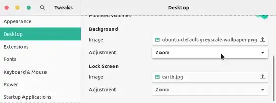

As an alternative, you may use another GUI application called (GNOME) Tweaks to get those extra options. To install it first run
sudo apt install gnome-tweaks
Then launch Tweaks and go to the 'Appearance' section on Ubuntu 18.04 and later (or the 'Desktop' section on Ubuntu 17.10). You'll get options to adjust the background and lock screen images.

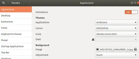

On Ubuntu 18.04 and later, the settings can be found under Tweak's 'Appearance' tab (instead of 'Desktop').
screenshot
