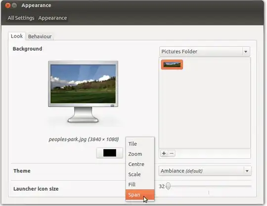

if using gnome-shell, in tweak tool under desktop there is an option to have the image span the desktop. This makes it go across both monitors(or all).
No Nitrogen Necessary
Unity also has this same option as shown below:
Appearance options - span

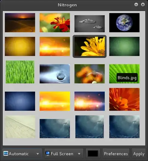

First you need a wallpaper large enough for both monitors. You can either make one with the gimp or down load one. Alternately you can use a separate image for each monitor.
You can then install a handy little application, nitrogen
sudo apt-get install nitrogen
You then run nitrogen with the path to the directory with your picture(s)
nitrogen ~/Pictures
And select the image. At the bottom of nitrogen, select "automatic" and "Full screen" as options. alternately you can use nitrogen to set a separate image on each screen, up to you (sort of depends on your background images).
nitrogen

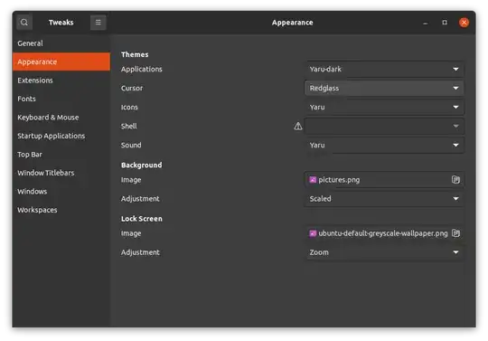

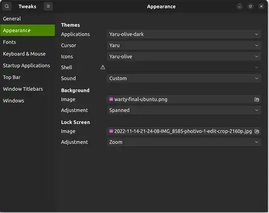

I will suggest the same as @Alex Nolasco, however, the gnome-tweak-tool has no longer support for Ubuntu 22.04 LTS (Package 'gnome-tweak-tool' has no installation candidate)
Instead of that you can install the latest gnome-tweaks
sudo apt install gnome-tweaks
and run gnome-tweaks, go to the Adjustment and select Spanned from the drop down menu. Do not forget to use high resolution image to get the best view.
