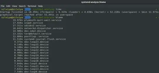

The default booting time is : 47s.

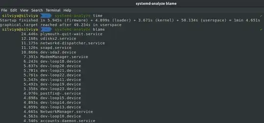

What I have tried :
  1. Added noresume parameter in kernel boot. Literally from the post above, someone cut booting time by 31s !
    I upgraded to 18.04 yesterday and I had the same problem (it took 52 seconds to boot). After setting the "noresume" parameter, it took 21 seconds.
    Result : (sorry forgot to take a screenshot): 57s (10s slower). Why ?

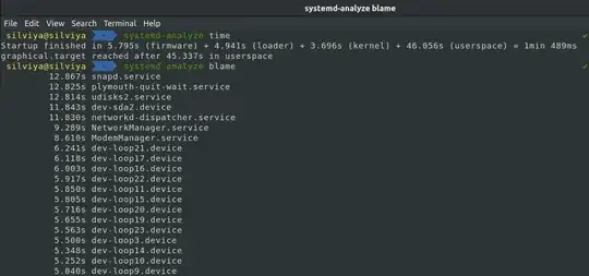

  3. Disable Networking during booting :
    systemctl disable NetworkManager-wait-online.service
    Result : Booting time was 51s (4s slower).
Why did I miss from steps above ? How did my machine ended up booting slower ?
Why did noresume which was supposed to prevent resume partition makes it slower instead ? Any other advice to decrease booting time ?

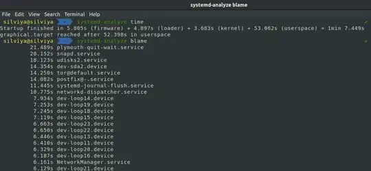

UPDATE
Following suggestion from WinEunuuchs2Unix, I tried :
  1. Disable networking as in step (3), and remove the journal flush service and vacuum it by changing :
    nano /etc/systemd/journald.conf
    change
    Storage=auto
    SystemMaxUse=50M
    SystemMaxFileSize=1G
    SystemMaxFiles=5
    My original journal disk usage was 2G, now it's down to 200MB. But system-journal-flush.service time doesn't seem to get faster, it's still 11s.
    Also, before changing its settings, flushing time was 3.xx s. Now it's 10.xx s instead.
Result, booting time : 52s (5s slower).

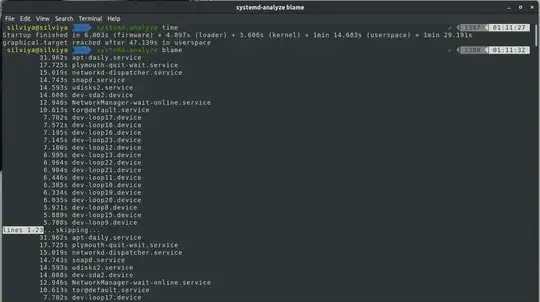

UPDATE 2
  1. Install haveged. Booting time : 49s (2s slower)
Just why.
